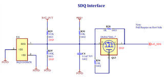

I am currently working on a project where I have implemented the BQ2026 IC for battery authentication. However, I am encountering issues when trying to read the unique ID of the BQ2026. Below are some specific concerns:
  1. Pull-up/Supply Voltage:
    Could you please confirm whether the correct pull-up or supply voltage for the BQ2026 should be 3.3V or 5V?
    (At present, we have connected it to 3.3V.)
  1. SDQ Line Voltage and Pull-up Resistor Value:
    What is the expected initial or ideal state of the SDQ line? When using a 10kΩ pull-up resistor, we measured a voltage of 0.5V on the SDQ line (at the GPIO pin of the controller). However, when the pull-up resistor value was reduced to 1kΩ, the voltage increased to 3.23V. Could you confirm the appropriate pull-up resistor value for the SDQ line?

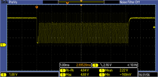

    While attempting to read the default value of the authentication IC, I am consistently receiving "0000000". For reading the value, I am using an ESP-WROOM-32 module. I have attached an image for reference.
    (Note: We are using the ESP-WROOM-32 just for proof of concept at this stage.)
  1. Capture the signal wave foam ESP-WROOM-32 of GPIO - D4.

    3. How does the device respond when you issue a reset pulse for tRST duration?
    4. Can you show the waveform for the reset pulse?

    I have updated the Rpup to 5K ohms, and after removing the C6 capacitor, the SDQ line voltage has now increased to approximately 3.2V from the previous 0.5V. We are now able to successfully read the device ID. It seems that the C6 capacitor may have been causing the issue in the design.

    Thanks for the update. For some reason, the schematics did not show up earlier in my view of the e2e post and I didnt notice the capacitance on the SDQ pin.
    Yes, any capacitive load would violate the device timing spec and as you figured out, that was the cause of the issue in your design.
