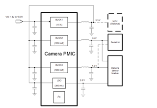

In this application circuit 3.3V is given to  MCU(optional)..
For my application can i connect 3.3V to any of the load (encoder)?
Does it creates switching problem when its connected to load?
Because buck 1 input is given as input to others buck2,buck3,ldo.
And please kindly share your application schematic
  • Hi Ananthi,
     Yes; the buck1 3.3V output can be connected to any load including to the input for others buck2, buck3 and ldo; as long as the total load <1.5A.
     TPS650332-Q1 is a GPN; you may need an OPN for all details settings; please contact your local TI sales for more details.
