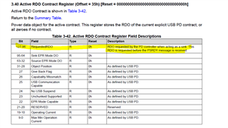

  • Hi Jan,
    There was some confusion on my end, and I forgot to share some important information.
    Part of the fix included adding extra bitfields to register 0x35. See the image below for the added bit field. The RDO you are looking for should be found in bits 127-96.
    The RDO will follow the PD spec, and should be similar to the 0-31 format, just with a different offset.
    Please try this and let me know how it goes.
    Thanks and Regards,
    Chris
  • Hello Chris,
    I have a good and bed news.
    The good thing is, that it seems, there is immediate update to register 0x35 in the bits fields you described to me - bits 96 - 127. Excellent work, I can finally read out requested profile number immediately after Sink transition completed interrupt without the need of any delays or workarounds.
    The bad news is that there is still some minor bug as it is not working as expected. After power on, my debug SINK device establish contract at 5V (profile number 1), when I request then profile number 2 (9V) it drops the contract and ends up with detach state. If I request any other profile number e.g. 3,4,5 (12,15,20V) then it establishes new contract without any problem and I can be switching through profile numbers as I want - e.g. 1 - 5 - 4 - 3 - 2 - 1 - 3 - 4 -5 - 1 - 4 and so on. Only problem is as I wrote, when I want to switch from 5V contract to 9V contract (1 - 2).
    Would you have any ideas, why is this happening and how to make it work?
    Thank you

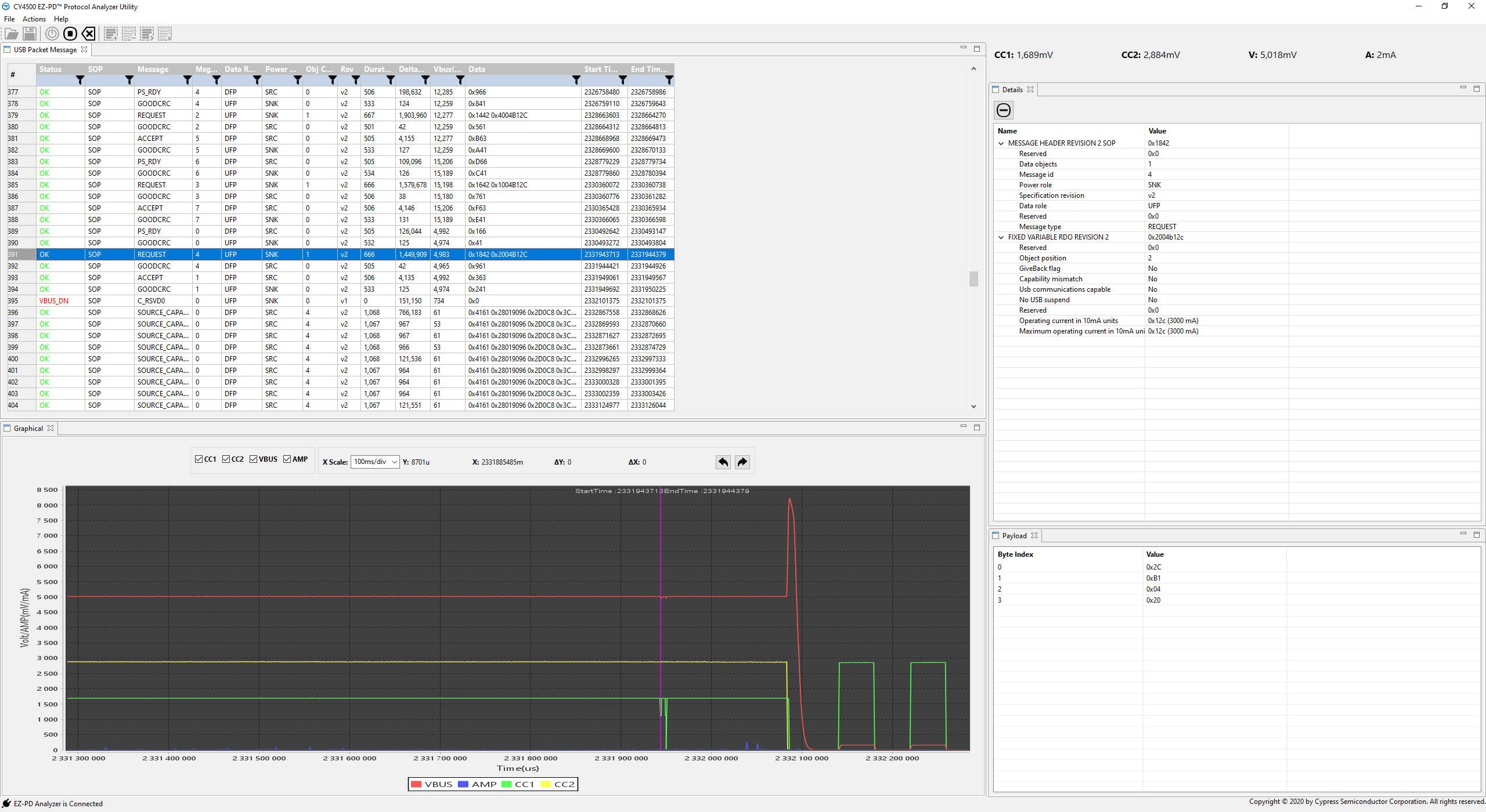

  • Hello Chris,
    I can transition to 12V, 15V and 20V profiles from 5V profile without any problems, it only occurs when I try to transition to 9V profile.
    Logs are attached. I did 5V - 20V - 5V - 15V - 5V - 12V - 5V - 9V transitions in this log, and error occurs at the end of it.
    I communicate with TPS25751 and BQ25731 over I2C at 350 kHz, so it is pretty fast, I just read 0x35 register and then immediately change the BQ25731 settings.
    Thank you

  • Hi Jan,
    From the shared logs, I don't see anything unusual. I'm not too sure what is happening here, but have a couple items we can test.
    The 5->9-V transition seems to happen within the required time, and it does appear to be happening correctly.

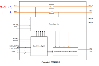

    Could you share your schematic? From the json you shared, it appears that the 5V source PDO is provided by PP5V, and the other PDOs are provided by PPHV?
    What voltage is PP5V at, and what voltage do you set PPHV to when a 5V contract is negotiated? These should be measured on the board if possible. In the past we have seen issues with RCP triggering if PP5V is higher during the power path transition which can sometimes cause a fault. I'm not sure if this is the case, but is just a though.
    Can you try this .c file? I added the "Power Event Occurred Error" interrupt. Everything else is still the same as before.
    jan_12_2.c
    Do you see any interrupts from the PD controller when the 9-V transition fails? Can you report which ones, and if necessary, read the relevant registers to determine what may have changed?
    Here is another .c File that changes the PDO1(5V contract) to PPHV instead of PP1.
    If possible, please try this one and report if the voltage transitions still work.
    Jan_12_2_PDO1PP3.c

  • Hi Jan,
    Thats great to hear.
    I had some help from a colleague, and we had a suspicion that it could be related to the power paths, we do not need additional debug if you are satisfied with the result.
    For your understanding:
    Originally, your project config worked as in the red case, where PDO1(5-V) was supplied through PP5V and the rest through PPHV. It would switch between power paths when going from 5 -> any other or any other -> 5
    Now it is configured to supply all of them through PPHV. For sourcing, we do need 5-V on PP5V for additional parts of the IC, so the 5-V there is still required.
    For future reference, the changes you needed required a FW change and a Power path change. The FW change was related to the expanded 0x35 Active contract RDO and it's update timing.
    I am working with the team to bring the changes into one of the next GUIs as well as updating the TRM with the register information. It should come within the next month or two, but you should be fine using the provided image. Within the gui, the Tool Release note should indicate if the feature has been added. The change should be related to "Updating Active RDO....".
