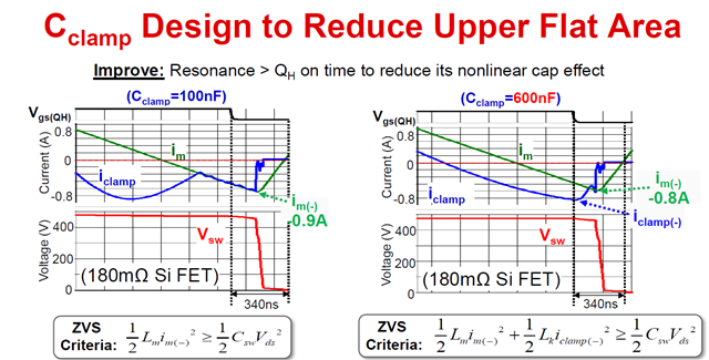

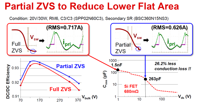

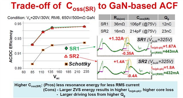

    - Is it possible to lower the negative current used to achieve ZVS ? In my simulation, I needed a lower negative secondary current (-3.75A) than in reality (-4.6A). Consequently, the losses are higher than expected even though the real Coss is lower than in simulation. I understand that this current is tuned automatically to achieve ZVS on the primary FET, but I want to be sure.
    Marc
  • Hi Marc,
    I think this might be difficult to achieve as most of this is internal. Ultimately this has to be as you pointed out optimizing for Coss of primary and SR FET along with the clamp capacitance. Below are some tradeoff based on study considered:
