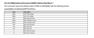

  • Hello Gene,
    You should be just reading from 0x0060 Lifetime Data Block 1, then referring to the GG and HH bytes of the register. Please see the following image taken from the device TRM for the layout of the register.
    Robert.

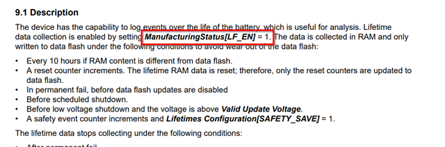

  • Hello Gene,
    Yes, you have to enable lifetime data collection, please see the following image taken from the bq27z746 TRM.
    To read Lifetime DataBlock 1 0x0060 you would just write 0x0060 to 0x3E, then you can read the data back from 0x40.
    Robert.

  • Hello Gene,
    You should be able to read the temperature lifetime parameters by reading 0x0060 Lifetime Data Block 1.
    Robert.

  • Our battery pack manufacturer is sending us battery packs with Lifetime logging disabled.  We would like to enable lifetime logging and display max and min lifetime battery temperature.
    Battery packs use a T.I. BQ28Z610 as a battery gauge.  I can read and write to this chip over I2C.
    Battery as received from manufacture:
    AltManufacturingAccess() 0x0057 ManufactringStatus     = 0x0018
    AltManufacturingAccess() 0x0060 Lifetime Data Block 1 has the following hex data:
                   00 00 00 00 00 00 00 00 00 7f 00 00 00 00 00 00
    I enabled lifetime logging by writing 0x00 to AltManufacturingAccess() 0x0023 Lifetime Data Collection.
    I reset lifetime data by writing 0x00 to AltManufacturingAccess() 0x0028 Lifetime Data Reset.
    Battery now:
    AltManufacturingAccess() 0x0057 ManufactringStatus     = 0x0038
                   28 0f 00 00 5d 03 0b fe 1d 16 00 00 00 00 00 00
    As you can see the fields that should contain max and min temperature information are zero and they are not updating.  Also cycle count at 0x002A does not update.
    What else do I need to do to enable Lifetime Data logging?  Do I need to reset the BQ28Z610?
  • Hello Gene,
    To enable Lifetime data logging on the BQ28Z610 gauge, you need to make sure ManufacturingStatus[LF_EN] = 1.
    Robert.
