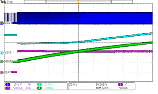

    I am not sure what trouble you encountered with min system voltage. See below an example of SuperCAP charging with EN_LDO=0.
    I keep the min system voltage =3.6V as default, ICHG=1A, Max charge voltage =4.2V.

    Due to PFET voltage drop, please pay attention to the PFET thermal dissipation.
    Tiger
  • Is the Min Sys Voltage setting completely ignored then when EN_LDO=0?
    When charging is OFF,  the BATFET is OFF, the minimum system voltage is still effective.
    When charging is enabled and EN_LDO=0, the system voltage will drop below the min system voltage setting by pulling down the BATDRV voltage, however, due to the PFET threshold, the system voltage is about 2V when VBAT=0. Full ICHG current is available to charge the super cap. See below test waveform.
    Tiger

    Thank you for sharing your exact test setup and measured waveform. This is very helpful to see that we are observing the same thing.
    My confusion is that you set Min System Voltage= 3.6V, yet when you start charging the voltage droops to 2V so in fact VSYS has fallen below this minimum system voltage. This works great for my application (I don't care about Min System Voltage when the supercapacitor bank is at 0V and begins charging, only when it reaches 6V), but this doesn't seem like the correct behavior given the definition:

  • The device employs Narrow VDC architecture (NVDC) with BATFET separating the system from the battery. The minimum system voltage is set by VSYS_MIN register REG0x0D/0C(). Even with a depleted battery, the system is regulated above the minimum system voltage.
    To operate above min system voltage, it requires the BATFET in LDO mode to support the voltage difference. When LDO mode is disabled, the VSYS will drive to the VBAT as close as possible.
    I tested on BQ25700AEVM.
    Tiger
