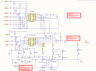

I am planning to use BQ7790518 battery protector for 8 and 6 Cells. The following specs are required:
1. The cell level overvoltage cutoff at 4.3V.
2. The temperature cut off can be 150 deg C at board level.
3. This circuit will not be used during discharging, only charge OV protections are required.
Can I short the SRP and SRN pins?
