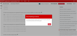

Hi TI experts,
       My colleague tried to download configuration information to TPS25751EVM.But meet the following issue. Can you help to analyze the issue?
  • Hi Aiden,
    Thank you for reaching out!
    Here are a couple suggestions:
    1- Try to reload the GUI Tool
    2- Ensure EVM is powered on via Type-C port and TIVA is connected via Type-C as well
    3- Ensure that the EVM COM port is connected to the GUI.

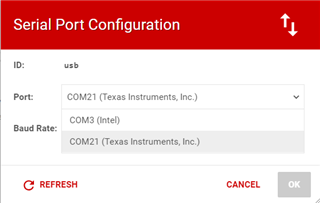

    • Go to "Options" --> "Serial Port Settings" --> "Port" (make sure Port selected says "Texas Instruments"
    Please let me know if this helps!

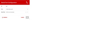

    The Port select is "COM3(Microsoft)" as shown below. Is this the reason for the flash error?
    How can this be selected as "Texas Instruments"?

        Thanks for your reply. The following is our test config file. FYI. Downloads will fail in 70%.
        In addition, could you provide a verified download file for us to test. Thanks a lot.

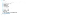

        The PC found port just named USB serial Device. Maybe we missing some USB driver for EVM TIVA MCU.
        Our company maybe have some permissions limit. Can you help to provide the EVM USB driver directly?
  • Hi Aya,
       I used my PC to re-test the download process is succeed. My own computer is WIN 10 and company PC is WIN 11.Does it matter if the operating system is different? And in my computer the port also says "Microsoft".

    Could you double check this again?
    The Serial Port Configuration should look similar to the image below:
    I will get back to you the operating system requirement (if applicable).

  • Hi Aya,
         Yeah, I confirm my computer says Microsoft and the GUI Tool display Flashing completed. My company computer also says Microsoft but the download process will pending by 70%.
