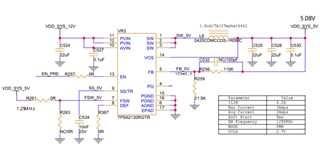

The circuit design of TPS62130RGTR is shown in the figure below.

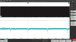

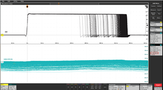

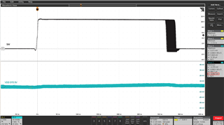

We conducted the electrical performance testing on the TPS62130RGTR according to its rated maximum current of 3A, although our actual application current does not exceed 2A.
we found that for different batches of the 62130 chip, the Jitter test on SW-GND shows significant variations under both steady-state and transient power load conditions.
The comparative test waveforms are shown below.
1、Batches with better Jitter test performance
(1)steady-state test conditions
(2)transient test conditions
2、Batches with poorer Jitter test performance
For batches with poorer Jitter test performance, could you please analyze whether there might be any potential risks with the current design? Do you have any better suggestions?

  • Hi Colin Chen,
    The following two test waveforms are from two batches of chips. Under steady-state conditions, they were tested with an electronic load carrying 3A.
    As shown in the left figure below, two chips from this batch were tested, and the jitter test results were consistent and good.
    As shown in the right figure below, two chips from this batch were tested, and the jitter test results were consistent but poor.
    When the load is constant, there is significant jitter and frequency variation observed.Is this an indication of instability in the control circuit?
    Please help analyze and confirm this.
    Thank you!

  • Hi Yanwei,
    Were the two batches chips tested on same board?
    Were the test condition for both result same?
    Could you make a ABA test to check whether it caused by board difference.
    Anyway, the jitter is normal for DCS control and it is not the indication of instability.,
