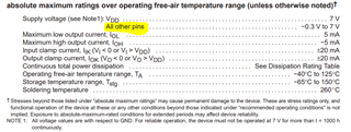

    If you look at the absolute maximum ratings all pins maximum can be connected to 7V.
    Yes, you should be able to drive the WDI pin with  DSP.
    Since you have TPS3306-33 variant, Sense 1 will casue the Reset pin to assert when Sense 1 voltage level goes below threshold (4.55 V), therefore, SENSE1 can be directly connected to 5V rail and Sense 2 will assert the reset when the voltage level at SENSE2 goes below 2.93V, there need to connect 3.3V rail.
