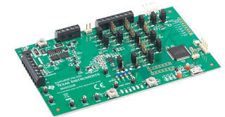

Is it possible to get the original jumper setting of the bq40z80 evm board ?
Hello Adrian,
We have used the same jumper settings, but could not establish communication with the bqstudio it was not able to detect it
Make sure to press the "Wake" button. Can you share a picture of how the bq40z80 is configured.
Adrian
Do you have a voltage applied on the j12 terminal block (BAT). Make sure there is a resistor ladder between each cell connection if you are using a power supply to power the EVM.
Adrian
Can you share either a picture or high level diagram of how you have the EVM set up.
Adrian
