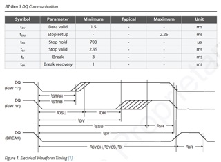

  • We're following these specifications that were provided by the battery manufacturer:
    Comparing these timings with the o'scope plots in the previously attached PDF we cannot find any violations.  There also does not appear to be any difference in our signal output between when the battery does and doesn't respond (except as explained, when the battery correctly attaches itself to the DQ line, there is a slight drop in voltage).  The manufacturer outlines this behavior via this table:
    Images in this post are copyright Bren-Tronics.

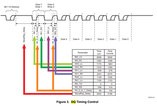

    The timing specs I provided are from the BQ34z950 datasheet, if the cell manufacture provided different specs please contact the cell manufacture with this issue.
    The BQ34z950 has different parameters related to timing, I am asking what these parameters are configured to on your gauge?
    Can you pull your configuration from the gauge?
    Diego
  • BREAK 3125ms, Tsv 3375ms, 1-bit 650ms, 0-bit 1875ms, BREAK recovery 1500ms
    The Break you have is 3125ms, the spec from the ds is 3ms, this will cause a timeout.
