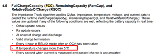

I noticed that the FCC update is related to temperature. May I ask how long it takes for the FCC to update when the temperature changes by more than 5 degrees?
Is it an immediate update?
Hello Elias,
If the temperature does not change by more than 5 degrees before the next FCC update then FCC will update.
