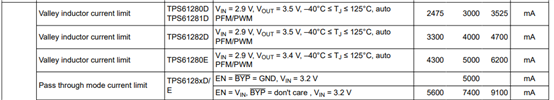

    1. Whats OCP trigger value for boost mode?
    For the OCP value, you could find it in d/s as below, which is the inductor valley current limit.
