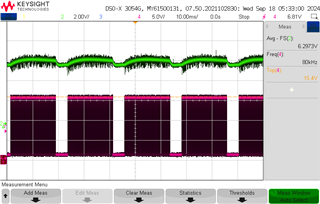

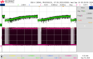

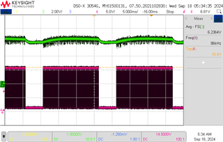

Hello, I recently encountered a problem when testing the VCOMP of UCC28180
Below is my circuit diagram
I tried sending different voltages to VSENSE
When VSENSE=4.5V    CH1:VCOMP  CH2:VGS(GATE)
When VSENSE=2V
When VSENSE=1V
I would like to ask if this waveform is correct because it looks a bit strange.
And should VCOMP be around 5V?
