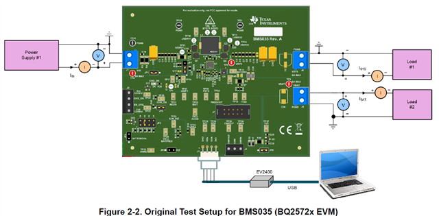

Hi, Expert
I'm testing BQ25720 as following setup, but VSYS always drop when heavy load.
Test condition:
Vin=20V;
VSYS_min=12.3V
ISYS=0A to 6A;
IBAT=0A;
JP3=4S;
Test result:
VSYS(V) ISYS(A)
12.43
0
12.28
1
12.28
2
12.27
3
12.26
4
11.71
5
9.64
6
As you can see, when ISYS increase to 6A, VSYS drop to 9.64V. Does it reach any protect threshold? Or I have to change any setting to solve this issue?
Please check attached register file for reference. Thanks.

  • Hello Allen,
    I think this issue is related to power requirement.
    You have an Input current limit of 3250:
    Input power:65W
    Output power:57.84W
    your feficiency is aound 89%, the expected efficiency is around 90-95%.(This could be related to the way the power is measured)
    I recommend increasing the input power to support the output power.
    Christian.
  • Hi Christian,
    Thanks for your reply.
    I increased Input current limit to 6350mA. (Power supply is GPC-3060D which can support 6A)
    But still found that when ISYS increasing and input current near 3A, Charger status IN_IIN_DPM would change to "In IINDPM" and VSYS drop.

  • Hello Allen,
    Can you enable all of the ADC and recollect the two test setups?
    Christian.
  • Hi Christian,
    I enabled all of ADC and found that Input current read back would be clamped at 2950mA when charger status "In IINDPM".
    So I disable EN_IIN_DPM let input current wouldn't be clamped, it works also solved VSYS drop issue but I still want to know why IIN_DPM was trigger at 2950mA even increase IIN_HOST to 6350mA?
    Attached register file for reference. Thanks.

  • Hello Allen,
    You have EN_EXTLIM enabled.
    When this is enabled the input current limit is set by the lower value of ILIM_HIZ pin and IIN_DPM register. The ILIM_HIZ pin is limited to around 3A on the EVM. If you disable this bit the charger should only rely on the input current limit set in the register.
    Christian.
