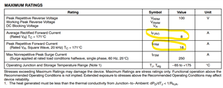

In the EVM the output current is 5A, whereas the diode used is rated for 20A. What was the reason behind it ?
What was the worst case current and how was it found ?

It is not recommended to use LM5085 to handle 10A. Please consider to use synchronous buck controllers like as LM5148 or LM5149.
Non-synchronous buck converter is usually used to handle up to 5A due to the thermal limitation of the components.

Okay, but that was not my question. I need to know the reason why the diode with that current ratings was selected for the 5A output.
Okay, what should the minimum rating be for it, Lets say for 10A output what should the headroom be for the diode ratings?
