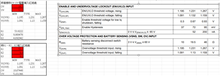

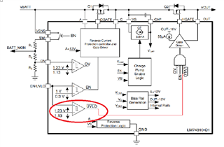

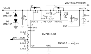

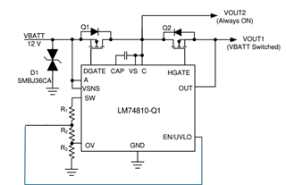

For the LM74810QDRRRQ1 component under UV conditions, should the parameter used be the RISING value of 1.231 or the FALLING value of 1.132? The requirement is UV: 6.5V, OV: 18.1V.
Below is our calculation method; please help confirm it. Thank you!
