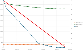

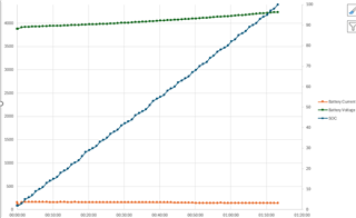

Dear Sir,

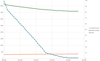

we measure the charging and discharging curve, and found the discharging curve is not linear. We would like to improve the accuracy.
The doc sluuah7b mentions that "this pre-optimized golden file allows the end user to experience higher initial accuracy out of the box without having to wait for the gauge to learn during operation".
Is there any SOP to output the pre-optimized golden file or it needs TI local FAE support?
    I do not see any issues with the SOC reported by the fuel gauge. The battery capacity is not linear. I recommend ensuring that you have successfully completed the learning cycle.
    Robert.
  • Dear Robert,
    the test is keeping system display on  and idle only, so the target discharging SOC should be like the red line.
    so we would like to make the pre-optimized golden file, please let us know how to do it.
    BR
    Peter
