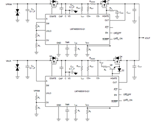

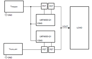

Hi team,
I am looking for a design suggestion for automatic switching of battery supplies (primary to secondary) in one of our Automotive projects. The use case is that when the primary one is dead to ensure continuous power supply to the ECU. So kindly suggest a solution for the battery switching.
The primary battery supply: 24V.
The secondary battery supply: 12V
The Continuous load current: 20A.
