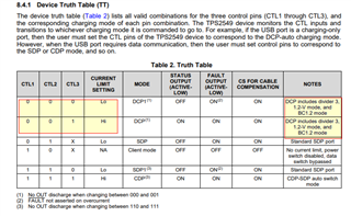

Does TPS2549/TPS2546 support APPLE 2.4A? Do we have a device that supports Apple 2.4A?
Many thanks!

Yes, 2.4A advertisement is supported as divider 3 mode in the TPS2549 and TPS2549 datasheets.
Chuck
Customer also want to know how to use APPLE 2.4A in TPS2549?
Arabella
Arabella,
Both DCP control decodes will automatically turn on divider 3.
setting CTL1 and 2 to logic high will turn on DCP mode. CTL3 allows the customer to switch between 2 different current limits to support cases where 900mA needs to be supported when DCP does not detect a higher current state.
