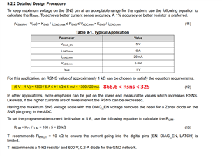

The calculation for Rsns is confusing. Per the values in table 9-1, equation 12 computes to 866 < Rsns < 325.
How does a 1k resistor fit within the range calculated by equation 12? Seems as though the equation is flawed.
For my design requirements:
Vsnsfh = 3.3V
Vhr = 1V
Iloadmax = 6A
Iloadmin = 20mA
Vadcmin = 5mV
Ksns = 1300 A/A
Plugging these values into equation 12 yields:
498.3 < Rsns < 325
Any assistance with Rsns selection would be appreciated.
