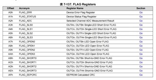

May I know what is the delay time for TPS929240-Q1 from chip fault to register reported the fault? Thanks.

Hi Ivy,
Please refer to below readback command, once you send a read command, after the CRC is verified, the device immediately feeds back the DATA and ACK byte, after the MCU read this feedback, it can send the read command again. If the periodically read is required, you can evaluate this in relation to the specific read command and the baud rate. Thanks!
