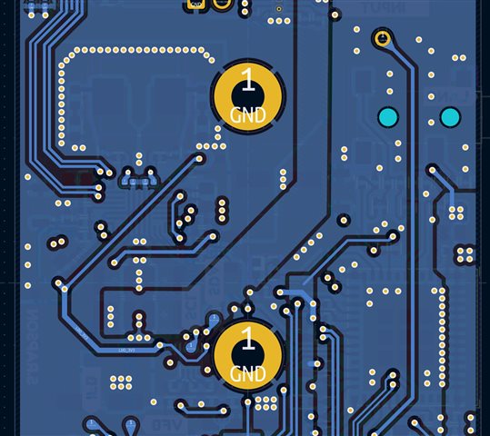

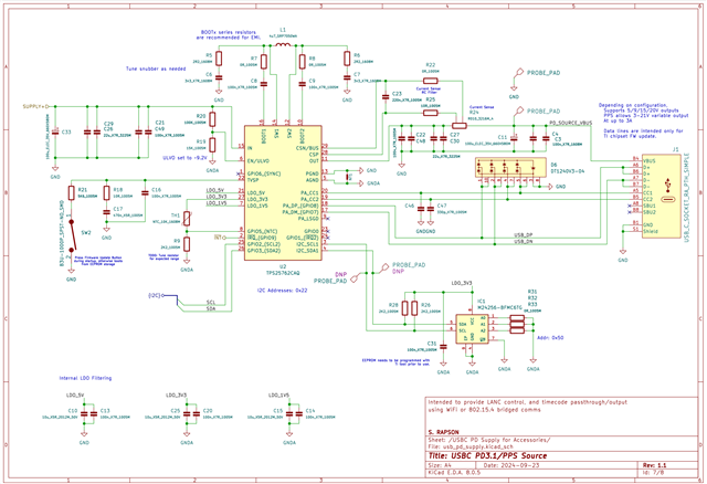

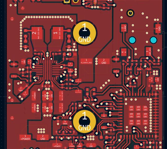

I'm having trouble bringing up a custom board and would appreciate help diagnosing the fault. When connecting USB devices to the output the regulator immediately dies with a short across the input rail. Two different boards showed identical failures with CAQ parts, and an attempt with a CQ part also failed.
The relevant sections of the board design are attached for reference, with PDF and other relevant files in this Google Drive share.
I based the design on the datasheet reference, checked against the EVM and PMP40934 reference.

    I am concerned about R5 and R6 being thermally capable in the system.  The seem to be 0402 case size and I don't think that will support the switching current.  Are they populated?
    Other than the size of R5 and R6, your schematic and layout look quite good, so I do not see anything on the base design that is concerning.

    The snubber resistors R5 and R6 are 0.25W rated, I agree these are a size or two smaller than reference designs.
    I can't find a datasheet value for the BOOTx currents to double-check the passives on those pins.
