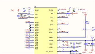

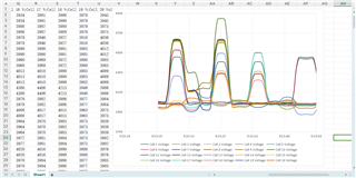

We have an issue with host cell balance,When i use 0x0083 CB_ACTIVE_CELLS() command to strart balancing,i found the cell volt data collectes by bq76952 become incorrect,show as follow image:
The control logic is to balance non-adjacent cells that meet the balance conditions every 1s,as bit set 0x55555555 or 0xAAAAAAAA.

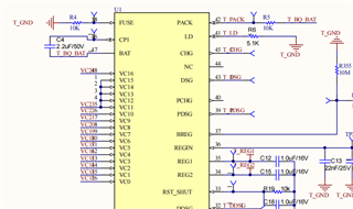

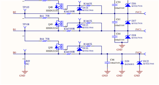

The schematic show as follow image:
Looking forward to you reply.

    Thank you for sharing your schematic and data/images. Section 2.5 Voltage Measurement Accuracy During Balance in the Cell Balancing with BQ769x2 Battery Monitor Family application note may help explain some of the inaccuracies you are seeing.
    I think smaller resistors may potentially help in your case as we personally recommend a maximum input resistor value of 100 ohms.

  • Hi Alexis,
     Thanks for reply ,I think that now my circuit has been designed exactly according to the manual and meets the requirements, but this does not seem to solve the issue; And the voltage error is more than 100mv, not about 10mv mentioned in the instruction manual. What other aspects do you think might be contributing to this issue?

    Hope you had a nice holiday! Thank you for sharing your .gg file. I noticed that in VCELL_MODE (Settings:Configuration:Vcell Mode), you only enabled Cell 1 to Cell 9, and Cell 16, however, on your schematic, you are using VC0 to VC11 and VC16.
    Please try enabling all the correct cells and see if that helps. Vcell Mode is important in disabling protections as well as telling the part, which cells are adjacent during balancing, so it knows which channels to turn off.
