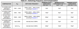

Customer is having below query on webench simulation and default values selected, can you please help on the same.
- For setting up the mode, why did Webench select 10k? I assume 1.8MHz FCCM mode is referring to table 8-1 in the datasheet (attach in the end of this mail). But as mentioned in our application we have approximately 104µF decoupling on the 1.1V supply, so wouldn’t 33k be a better selection?
- For selecting the frequency, what is the formula I should use to ensure I respect the minimum on time?
- From the datasheet we calculate D=Vout/Vin -> D=3.3/1.1 -> D=0.33.
fsmax=1/(tonmin * D -> fsmax = 1/(75ns * 0.3) -> fsmax=
This frequency seems too high
- When I apply these formulas in the example design on page 10, I cannot get the 2.67MHz. Is there something wrong with the formula?
- Why do you choose to connect MODE/SYNC to high, this forces PWM regardless of the load condition right?
