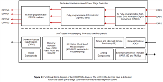

    The question you are asking relates to why the UCD is different than other DSP-based MCUs, such as the C2x products. In a typical DSP-based MCU, everything must be coded, including your ADCs, control loop and DPWM modules. However, the UCD has the control loop already etched into the silicon. Thus, the UCD is an MCU that is specialized for any power supply.
    In the below diagram from SLUAAS7, the entire control loop, from the Error ADC, PID and DPWM modules, are etched into the silicon. You can only change the parameters that modify the control loop, such as your Kp, Ki, Kd values.

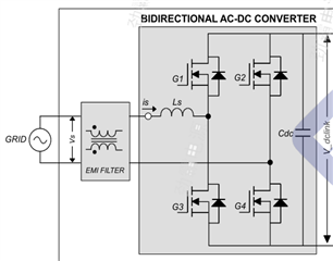

  • 1. Does L102 (487uH) in PMP20873 connect to ISO-RET_H in the daughter board? LMG3410RWHT forms the fast tube of the totem pole, while STY105NM50N forms the slow tube of the totem pole, similar to this
    2. Isn't there a rectifier bridge in PMP22220? Why is it also called bridgeless? Additionally, why is there no boost inductor in this bridgeless circuit?
    3. Is there any source code for PMP20873? What ways can I obtain it?
  • Hello Tom,
    1) Does L102 (487uH) in PMP20873 connect to ISO-RET_H in the daughter board? LMG3410RWHT forms the fast tube of the totem pole, while STY105NM50N forms the slow tube of the totem pole, similar to this
    Yes, you are correct. The Q1+Q2 MOSFETs are the slow FETs that rectify the AC line. The fast PFC FETs are on the GaN Half-Bridge daughter card. The PMP20873 uses the LMG3410-HB-EVM (https://www.ti.com/tool/LMG3410-HB-EVM).

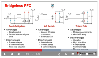

    2) Isn't there a rectifier bridge in PMP22220? Why is it also called bridgeless? Additionally, why is there no boost inductor in this bridgeless circuit?
    The PMP22220 is an AC Switch Bridgeless PFC. This is a unique configuration that is not the same as a typical totem-pole PFC. We have an explanation of the AC Switch Bridgeless PFC topology on our Bridgeless PFC video (https://www.ti.com/video/6123653129001). The below screenshot is halfway in the video.
    I believe the design uses the inductance in the common mode chokes (CMCs) and EMI filter as the boost inductance.

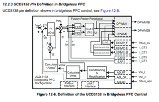

  • The traditional PFC approach has three inputs: AC voltage, AC current, and bus voltage. Then build a voltage outer loop and a current inner loop, where the voltage outer loop will use a multiplier. I found that in the PMP28073 circuit, there are also these three types of inputs. Is the algorithm inside the chip also a traditional PFC algorithm? Is there a multiplier integrated inside the chip?
  • Hello Tom,
    The UCD3138 has an integrated PID controller. You can see the PID stage on page 37 of the UCD3138 datasheet.
    All of the PID paths are etched into the chip itself. The only things you can change are parameters, such as your kp, ki or kd values.
    However, the PFC control requires more customization that is programmed in C. While we do not have a diagram for the totem-pole PFC, the UCD3138PFCEVM-026 User's Guide shows the block diagram on page 33 for the bridgeless PFC, which is similar to the totem-pole PFC. All of the processing in the dark grey box are etched paths in the chip itself. The rest of the processing is programmed in C.

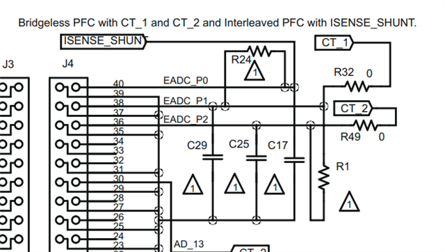

  • Is there a mistake in this diagram? The interleaved PFC only has one current input, while the bridged PFC has two current inputs?
      (Semi-Bridgeless=interleaved Bridgeless

    4) Is there a mistake in this diagram? The interleaved PFC only has one current input, while the bridged PFC has two current inputs?
    On the UCD PFC EVM, the Interleaved PFC measures the current using the ISENSE shunt while the Bridgeless PFC measures the current using two current sense transformers. This is not the only way to control an interleaved PFC. I think the design was chosen to maximize compatibility of having a Single-phase PFC, Interleaved PFC and Bridgeless PFC topology all on the same board. If you decide to control an Interleaved PFC with two current sense transformers, then you can modify the schematic and firmware to do so.
