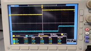

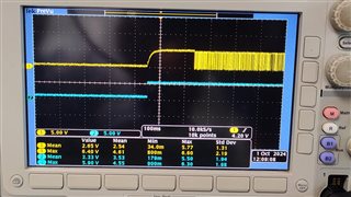

  • Hi Tiger,
    Here are the captures we got:
    1. With Vsw1(yellow) and Vbus_in (Blue)
    2. With Vsw1(yellow) and Chrg_ok (Blue)
    3. With Vbus(yellow) and VDDA(Blue)
    Please give us your feedback asap as we need to complete it urgently.
