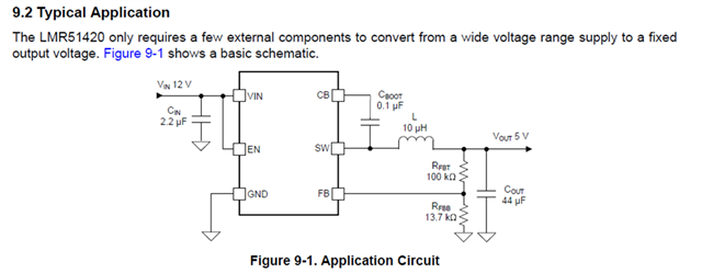

Hi team,
If this 10uh inductor is replaced with 22uh?
