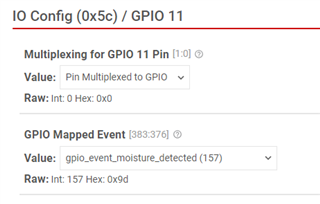

When evaluating the TPS25751, the default configuration had "GPIO Moisture Event" on GPIO1 and this functioned correctly.
To closer represent my previous design, I re-allocated the GPIOs so that "GPIO Moisture Event" was on GPIO11 (also on the pin header).

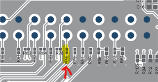

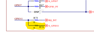

A change in voltage was NOT seen at the header. It appears that R74 links header to IC and this resistor is NOT installed, despite being shown in schematic.
