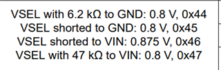

Could you explain differences between TPS62875B1 and TPS62875B2?

Hello Jihoon,
Thanks for reaching out to us.
The difference between the two P/Ns are the default Vout and I2C address. See figure below for reference.
TPS62875B1 (20A):
TPS62875B2 (20A):
