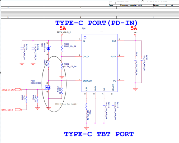

Hi Ti support team Members,

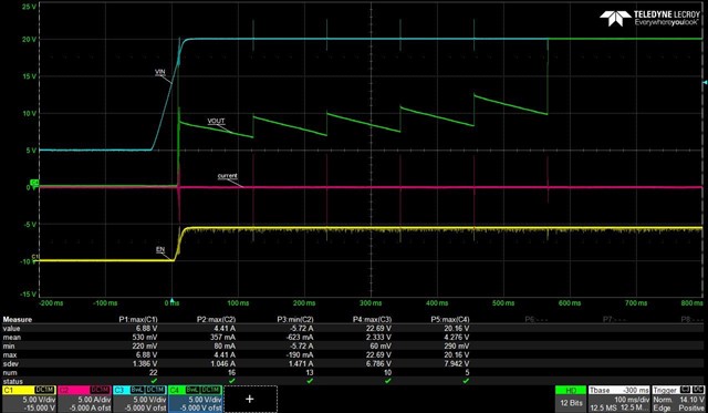

When PD Adapter plug in ( TBTA_VBUS2/ 20V) , TPS259474A output pin 6 voltage is abnormal keeping on and off about 5 cycles  (showing as below  Chanel 4 waveform)
Could you figure it out what is happened ; what kinds of protection is triggering ?
C1 EN PIN
C2 current
C3 VIN
C4 Vout
Thanks a lot

  • Hi Bryan,
    This looks like TSD happening during startup and then after 110ms delay, auto-retry of device trying startup again. During each startup, the output caps charge until eventually inrush current reduces enough to not cause TSD during startup.
    Increasing the DVDT cap to slow down the startup (reducing the inrush current) should resolve this issue.

    I try to put a  DVDT cap from 1000pF to 8200PF , it is until 8200pF to fix this problem
    Output rising time (0V~20V)  is about 70ms
    M/B total Cout is about 1130UF

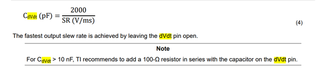

    Is that OK to put  8200PF for this design ( Is it need to add a 100-Ω resistor in series with the capacitor on the dVdt pin,
    although it is < 10nF? )

  • Is that OK to put  8200PF for this design ( Is it need to add a 100-Ω resistor in series with the capacitor on the dVdt pin,
    resistor shouldn't be required as it is within the limit.
