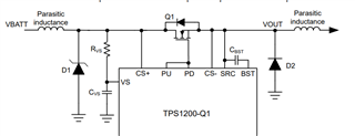

TPS1211-Q1: Connecting CS+/CS- between Mosfet Drain Source?
Part Number: TPS1211-Q1
Is it possible to measure the current and having short circuit protection from FETs internal resistance? What will happen in the turn-off state?

  • Hi Sarah,
    I mean the configuration like below.
    Asim
  • Hi Asim,
    I understand. You cannot connect the C+ and a C- between the drain and source with TPS1211 device. The Absolute maximum rating for voltage between C+/C- is listed at 0.3V. When the device is turned off and during turn on the voltage would be greater than 0.3V with RDSON sensing.
    The diagram you are showing is for TPS1200, which has a much higher absolute maximum.
