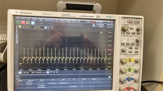

I made a 12V step down design with LM5010. Converter is quite tricky because it is referenced to -48V. Converter feed two fans with around 0.5A total courrent consumption. Sometimes Converter simply fail.
What could be the root cause of the failure?
Vin voltage range: -40V to -60V
Schematics:
choke details: CLF10040T-101M-D
