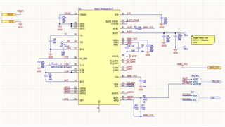

  • Hi Bill,
    Sorry for the delay. As things happen, we got two units to work more consistently. The 440 Ohm resistor for FOD resistor seems to work. We don't have startup failures, so I have not done any scope captures of the startup sequence. We actually have a problem where I'm not able to calibrate the FOD resistor as I have no feeling for what an acceptable value is or isn't.  Also, I have no way to measure the current on the TX I can maybe only measure the RX current.
    But the main problem is that it's charging very slow (maybe this is expected) and sometimes the charge terminates so it seems like the device (RX coil) has to be exactly center aligned with the TX coil. I would have hoped for some play (maybe 5 mm in each direction) that would still allow power transfer.
    But mainly we need to do FOD tuning, and I need to get it to work consistently. Feels like we are there. Im not sure if 440ohm is acceptable or should I also adjust the current limit resistor?
    See the schematic below
  • Hello
    440 ohms for Rfod (R18) is much larger than typical.  Current limit is set by R17 and R18, only increasing R18 will reduce current limit.  When R18 was increased was R17 decreased to keep current limit at the same point?
    What can you tell me about the battery charge IC?
    The current at OUT can be measured / monitored at ISET Pin.  Ratio is about 262 to 1.

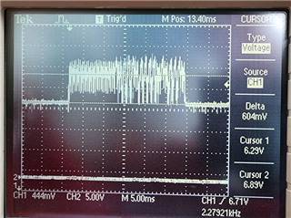

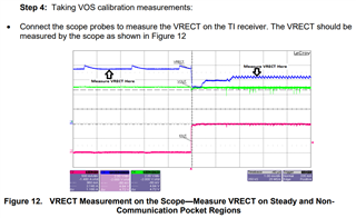

    I have done some tuning. After feeling quite confident that I was doing things right. I got to the point of measuring VRECT and this is where things started looking bad (maybe I don't know). The reason I say this is because my waveform doesn't look like the example waveforms. It might be my oscilloscope (very old Tektronix TDS 1012 100MHz 1GS/s). If you look at the example waveform in the user guide, I'm also confused as to where exactly I need to measure VRECT. It is showing two places. So, which one is the one I note in the table then? It seems to be the second one. I have included my captures too. I used the base of the waveform for my values in the table. Note the waveform I'm showing does have the Ros resistor fitted (20k) this was after tuning. Except form voltage differences my waveforms look the same before and after tuning.
    Example from SLUA731
    My captures:
    I did remove the GND lead of the probe and used a spring lead to get really close to see if the waveform looks different. But it looked the same, maybe clearer.
    I have attached my values pre_tuning and post_tuning. I had a problem tuning the VOS voltage as my locale didn't allow me to change the values at the time. I have in the meantime also fixed that from "," to a ".". I anyways just stayed with the 10mV default from the FOD GUI program.
    after tuning using RFOD = 285 ohms and Ros = 20k I got this below. A lot better than I had initially but still off by quite a bit.
    My assumption is I'm not measuring VFOD correct. Also setting VOS would maybe have made a big difference. I want to re-do the test. But I'll rather wait for your feedback.
