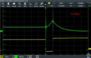

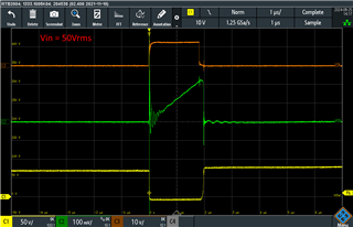

I have designed an off-line AC-DC converter, 85-253Vac universal input, 26V/3A output, based on UCC28780 and built some working prototypes. So far, so good!
I was working on one of these prototypes, trying to optimize the feedback compensation network, when it suddenly stop working.
Now, with no load, when I slowly increase the input voltage, I can see only one 2us pulse on PWML, up to about 50Vac input. With this input, the voltage on the Rcs sense resistor reaches only about 210mV.
   C1: QL Drain, C2: Vcs, C3: QL Gate

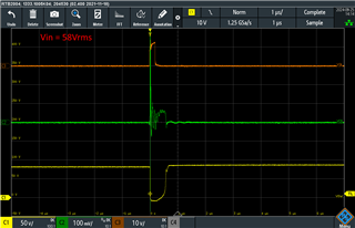

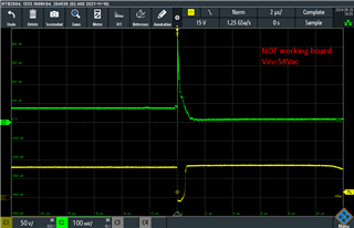

If I raise again the input voltage, when it reaches about 58Vac the PWML pulse reduces to less than 1us and stay there even with higher input voltage:
What can cause this behavior? I repeat: the converter was working properly before I did something (what?) that broke it.
I already replaced the UCC28780 and double checked the transformer, with no result... I was trying different values for the compensation network, but I don't think that this can be the cause.
Thank you very much in advance.
Sergio

    That document has a section for PWML shows 1 pulse only. It looks there is some short or open. Note the IC solder is quite delicate.
    The table 3 lists all we know why PWML only shows 1 pulse.
    already checked for short or open pins, all is ok. I replaced the UCC28780 with a new one, nothing changed.
    My question is: why the first PWML pulse width reduces from 2us to about 400ns when the input voltage is greater then 50Vac?
    Instead, it should remain at 2us in order to allow the Vcs to reach the threshold voltage of 280mV...
    Sergio

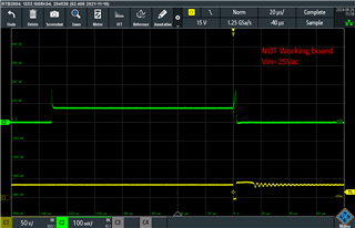

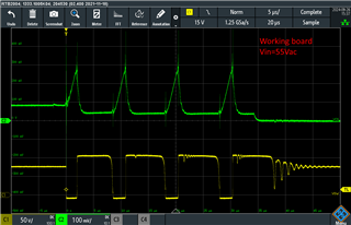

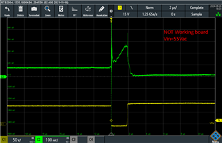

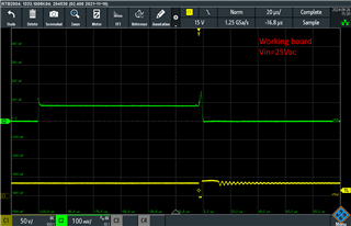

    It looks the IC detects the CS peak already over its threshold - so it looks there is noise. Can you compare this to a good board to see if your oscilloscope with full bandwidth?

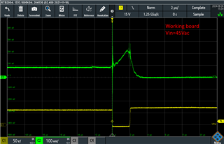

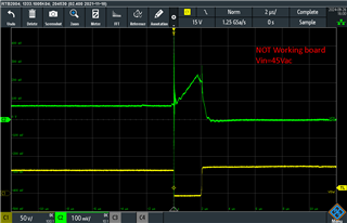

  • Hi Hong,
    here is some measurements done on a working board:
    And these are the same measurements taken on the broken board:
    All measurements show the voltage at the switching node and the voltage right at the CS pin of UCC2780, all made with the full bandwidth of a 300MHz oscilloscope.
    I checked everything many times and seems all ok, I am going crazy...
    Many thanks again, best regards
    Sergio
