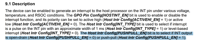

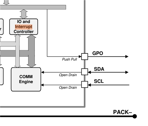

Hello, block diagrams for the BQ27Z746 datasheet indicate that GPO is a push-pull output. However, the technical reference manual says this is configurable as an open drain output. Can somebody please clarify if this signal can be open drain or not?
