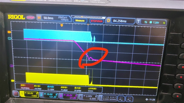

Question1:The customer uses LM5041B for DCDC module power supply, with an input voltage of 48V, output voltage of 28V, power of 500W. When the capacitive load value is large, it is about 5000uF. When the module is powered off, the output side voltage will reverse. How can I solve this problem?
As shown in the waveform below:
The yellow line represents the VDS of the output rectifier, the blue line represents VGS, and the purple line represents VIN voltage

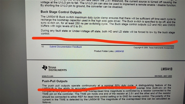

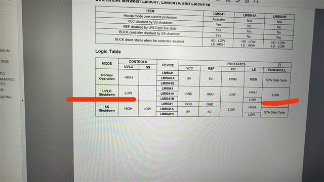

Question2:Is there a problem with the underlined description as shown below;
Thanks!

    -Thirdly, how are you supplying VIN voltage to the device? Are you using a power supply? According to your waveforms VIN is ramping down which will make UVLO pin to go down to 2.5V threshold and then the device will stop switching (as shown in your waveforms).
    -Finally, regarding description mentioned in the DS, it is explaining that LD, HD, PUSH and PULL pins will be low if UVLO is triggered at UVLO pin (2.5V).
