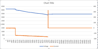

  • Hello Gopika,
    This is what the voltage and current graph First, there should be a constant current discharge, as you can see the current slowly start to increase as the discharge goes on. Also, at the end of discharge there is just weird charge pulse that occurs that should not happen.
    Adrian

  • Hello Gopika and Nithya,
    I looked over the log file and see something very concerning.
    As you can see, the voltage rapidly jumps about 300 mV without a change in current. This is mostly the cause of why the learning cycle is failing to complete. Battery voltage should not be jumping like this
    Adrian
  • Hi Adrian ,
    The charging process completed without any physical disturbances in the surroundings, but we will check this . If possible, could you suggest why this behavior might be occurring?
    Regarding the learning cycle, we reconfigured some threshold values (e.g., UVP, OVP) in the golden image obtained from the previous learning cycle. We need a new golden image. Could you please confirm whether we need to restart the learning cycle with the new configuration, or if it’s sufficient to take the new golden image directly from the 'Golden image' menu after reconfiguration?
    Nithya
  • Hello Nithya,
    I am not familiar with a voltage jump like this without a rapid change in current. There must be something external that is affect the voltage reading.

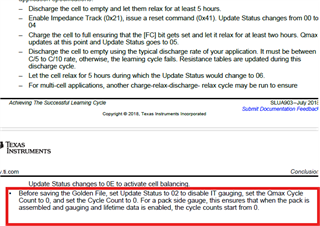

  • Hi Adrian,
    Thank you for the information.
    We have a Good news, and thank you for your continued support!
    During the final relaxation stage of the learning cycle, we observed the Update Status bit transition from 05 to 06. However, it did not change from 06 to 0E in the final relaxation.
    As per the reference document, we are now performing another Charge-Relaxation-Discharge cycle. During the relaxation phase after charging, we were able to observe the Update Status change from 06 to 0E. The remaining discharging cycle still needs to be completed.
    That said, we have a few concerns regarding the next steps in the learning cycle, and we would appreciate your guidance on the following:
    • Is it acceptable to take the golden image during the relaxation phase after charging (since the Update Status is 0E), or should we complete the discharging phase, as mentioned in the reference document, before capturing the golden image?
    • If discharging is necessary, can we take the golden image immediately after the discharging phase, or should we wait for the REST bit to go HIGH to ensure proper relaxation?
    • The reference document states that before saving the golden image, we must set the Update Status to 02 to disable IT gauging, reset the Qmax Cycle Count to 0, and set the Cycle Count to 0. Is this step required, or can we proceed with taking the golden image once the Update Status is 0E?
    We would greatly appreciate your insights and suggestions on these points.

  • Hello Devika,
    This is great news to hear! Since Update Status is 0x0E it is completely acceptable to take the golden image file from the gauge, you do not need to complete the discharge phase. It is necessary to reset the Qmax cycle count to 0 and the cycle count to 0. However you can keep update status to 0x0E.

  • Hi Adrian,
    As discussed, since we have not observed the transition of the Update Status from 06 to 0E, we conducted another Charging - Relaxation - Discharge cycle as described in the reference document. Due to uncertainty about when to generate the golden image, we created three different golden image files throughout the process after getting the Update status to 0E , as outlined below:
    1. The first golden image was generated when the Update Status changed to 0E during the relaxation phase after charging, without altering the Update Status, QMAX Cycle Count, or Cycle Count. At that time, the values were 0E, 2, and 2, respectively.
    2. The second golden image was generated after completing the final discharge in the Charge - Relaxation - Discharge process, as outlined in the reference document, without changing the Update Status, QMAX Cycle Count, or Cycle Count. The values remained 0E, 2, and 2, respectively.
    3. The third golden image was generated after completing the final discharge, but this time, we updated the Update Status, QMAX Cycle Count, and Cycle Count to 02, 0, and 0, respectively.
    Could you please advise which of these golden images would be most appropriate, or if we should make adjustments to any of them to better align with your specifications? We didn’t generate the golden image in the exact manner you described (with Update Status 0E, QMAX Cycle Count 0, and Cycle Count 0).
    We would greatly appreciate your insights and recommendations on this matter.
    Devika
  • Hello Devika,
    The third golden image would be most appropriate. Whenever the system is first powered up by the user, make sure the "GAUGE_EN" command is sent so update status changes from 0x02 to 0x06.
