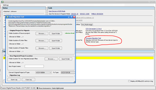

I need for "checksum" code conversion from UCD3138064 to UCD3138128.
May I ask if there are any relevant documents that I can refer to?

  • Firmware Migration Tool.
    Are there any instructions for use?
    There were a lot of errors there.
    EX:
    Message
    Fusion version: 3.0.81.0
    Source directory is invalid. Make sure directory exists.

  • My code here does not have the subtitle .cproject

    We are using .pjt files for over five years, but this tool only allows us to select .cproject files.

    You can just directly download the .cproject file and paste it into your directory. I do not think you can open the .cproject file with CCS but you can open the .cproject file using a text editor like Notepad++. I do not think you need to worry about any precautions unless you receive build errors after copying the .cproject file into your directory.
    Jonathan Wong
  • Hello Jonsthan,
    We previously attempted upgrading from v3.3 to v6, but encountered too many errors that couldn’t be fixed properly, so we decided to stick with the original version.
    The current issue I’m facing is when converting from UCD3138064 to UCD3138128: if I choose "Do not write program checksum (Stay in ROM)," the programming is successful.
    However, when I choose "Write program checksum," the programming fails and causes UCD3138128 to lock up.
    I suspect that the checksum calculation method in my firmware hasn’t been updated, which leads to the failure when writing the checksum.
    My current firmware modifications are based on the information provided in this document: https://www.ti.com/lit/ug/sluub54b/sluub54b.pdf.
    However, the checksum part is quite complex, and I’d like to ask if there is any more detailed code or method available.
    Thanks.
  • Hello Chieh-yu,
    I will check to see if there is more detailed code available. Can you please elaborate on the programming failure when you choose "Write program checksum"?
    Jonathan Wong
  • Hello Jonathan,
    I made a mistake. The programming was successful, but the device cannot be found after the programming.
    My guess is that the checksum was written incorrectly, leading to a read failure.
    Thanks.
  • Hello Chieh-yu,
    Please accept my friend request so I can send a direct message.
    Jonathan Wong
