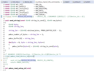

Dear TI Experts,
I referred to the "PMP21529" device_id.c file and modified the related functionality into the "UCD3138FW_BIDI" device_id.c file.

#pragma DATA_SECTION (device_id_string, "FixedDeviceID");
//const char  device_id_string[] = DEVICE_ID_STRING;
/* 20240925 add start */
const char  device_id_string[] = DEVICE_ID_STRING; //�إ�device_id��T, �ϥΤFbuild.h�Bdate.h�����Ѽƫإ�version��T�P���ɤ��
// pmbus_read_device_id() returns a string with the controller's model number that
// includes sub-release, build number, and build date.  Uses lots of macros to generate
// string at compile time instead of run time.
int pmbus_read_device_id(void)
    Uint32  string_len;
    // Determine the length of the string to send.
    // Do not allow string to overflow the PMBus buffer size.
    string_len = min(sizeof(device_id_string), PMBUS_DATA_LENGTH);
    send_string(device_id_string, string_len);
    return PMBUS_SUCCESS;
/* 20240925 add end*/
And commented out the original functionality for reading the device_id.

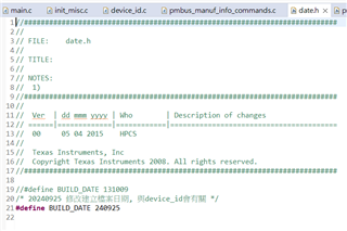

And modified the BUILD_DATE in "date.h".
The device_id has been confirmed to be correctly displayed in the GUI regarding the above modifications.

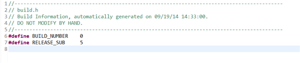

It can now be confirmed that the modifiable version parameters are RELEASE_MAJOR, RELEASE_MINOR, and BUILD_DATE.
I noticed that the message in "build.h" mentions "DO NOT MODIFY BY HAND." So when do the BUILD_NUMBER and RELEASE_SUB parameters automatically change? Or is it actually possible to manually adjust these parameters?
