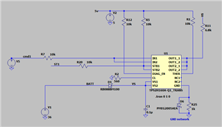

in the following conditions:
DIAG_EN -> pull-up to 5V
IN1,IN2 -> shorted, pull-down
THER -> pull-up to 5V
ST1, ST2 -> shorted, pull-up to 5V
OUT1, OUT2 -> shorted, open load
we're measuring at different supply voltages (12V, 18V, 24V, 30V) always the same power consumption: 27mA.
I see on datasheet that the maximum standby current with diagnostic enabled NOT in open load mode is 6mA.
However, since 27mA is quite high current consumption for standby (at 30V the device is dissipating 0.9W), is this value correct?

    Can you provide a schematic? Are you implementing a pull up resistor on the output to handle leakage current?

    This is my circuit. I have 6.8kOhm pull-up resistor.

    1.) I noticed you are using PSPICE. You will need to test this using the EVM to get "real" measurements. Simulation may not be perfect.
    2.) We recommend using a 20 kohm PU resistor not 6.8 kohm.
    3.) I see you have a voltage source connected to your IN1/2 pins, you previously said you were pulling these down.  Just want to make sure it is not being overlooked.

  • Dear Sarah,
    1) thanks, I will use EVM in future. However, I used it only to show you the schematic.
    2) I'm using 6.8kohm in order to guarantee a specific open load resistance detection range.
    3) I have a voltage source connected to IN1/IN2 just for simulation purpose. However, I'm talking about a real implementation in which the IN1/IN2 signals are pulled LOW by microcontroller.
    Do you think that the reason for this power consumption is the pull-up resistor value? By replacing the resistor the current consumption will be reduced?
    I do not see any current flowing in that resistor, all the current is flowing into VS pin.

    The PU resistor is intended to help with leakage current during an open load condition. The 20kohm could make a difference. i would recommend trying tis to verify.
    Where are you probing current? Just at Vs?

    I've tested the circuit with 20kohm and the current consumption falls downto 4mA.
    Now my doubt is: which is the minimum load resistance that is always recognized as open load by the device with 20kohm pullup? Can you share with me the equation to compute it considering also the effect of leakage current I(ol,off)?

    The data sheet lists a minimum and maximum V(ol,off) value that is the range for an open load condition in the electrical characteristics section.
    Please consider that Vout = Vs* (R_PU/(R_PU+ R_Load))
    The data sheet indicates that an open load event occurs when Vs - Vout < V(ol,off). You can plug these two in to determine the minimum R load that would still trigger the open load threshold.

  • Hi Sarah,
    are you sure about the Vout equation? That should be Vout = Vs* (R_Load/(R_PU+ R_Load))
    And what about I(ol,off)? It shouldn't be considered in this equation?
    Andrea
  • Yes that's correct. I swapped the R load and R_PU incorrectly.
    I(ol,off) is already accounted for in our recommendation for the R_PU value. I(ol, off) * R_PU = 1.5V < Vol,off.
