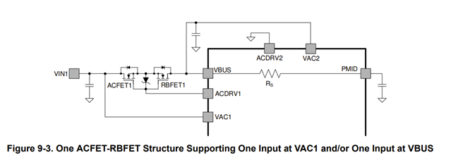

In my application, I wish to use a VBUS input only option like so:
But still I wish to use an external back-to-back load switch in order to isolate the large VBUS & PMID capacitance from the USB 5V input.

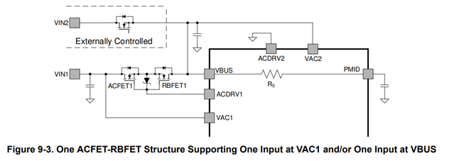

It should look like this example, without the VIN2 option:
My question is:

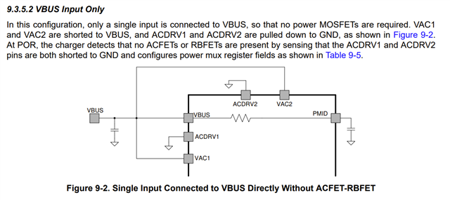

If I remove the VIN2 FET, should I leave VAC2 to be connected to VBUS (like in figure 9-3) or should I connect it together with VAC1 (like in figure 9-2)
Thanks!
