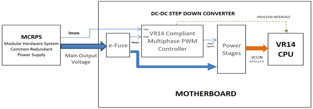

  • Hi Troy,
    Good day
    Thanks for your response
    Made below sample block diagram as for illustration only
    MCRPS will provide Imon signal to Isys pin  while the E-fuse/ PDB  will provide Vmon signal to Vsys Pin.
    I noticed that VR13/HC controllers don't have Isys and Vsys pin, Right? please correct me if I am wrong.
    Thanks so much

  • Hi Carlos,
    Thanks for clarifying. You are correct that the older controllers do not have an ISYS pin. VR14 controllers, like TPS53689T and TPS536C9T, which support PSYS do have an ISYS pin however.
    TPS53689T does not support SVI3, but can be used with AMD processor if it's okay to communicate over PMBus instead.
