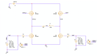

I’m working with a full bridge circuit utilizing the UCC21732 gate driver and SCT2080KE SiC MOSFETs with PSpice for TI. I applied a 400V DC input but did not achieve the expected output voltage. I was advised to use a bootstrap circuit, but I am still not seeing the desired results, possibly due to an incorrect implementation. Could you please assist me in troubleshooting and improving this full bridge inverter circuit?

  • Hi Biruk,
    Can you share your PSPICE file?
    You are still not using a bootstrap circuit as far as I can see; your high-side gate driver still uses the same VDD and VEE as the low-side:
    Can you use a voltage controlled voltage source with a gain of 1 to create a VDD2 and VEE2 rail from your low-side VDD and VEE rails? I think that will solve the high-side power supply issue in this simulation.
    Also, you will have a lot of trouble running simulations with a Dbreak true diode model. You should use a voltage controlled switch to emulate a diode to eliminate the complexity and aid in convergence.
    Sean

  • Hi Biruk,
    It seems you have a high expectation on what is possible to simulate in PSPICE for TI. It is really a tool for analysis of analog feedback, like op-amp circuits. There are other tools that are better suited for large switching circuits like these, such as Simplis and Simetrix.
    In order to get this simulation to work, I removed as much complexity as possible. I can drive the switches directly with the input voltage sources. Maybe this will allow you to set up a control waveform get some inductor current data. Using the gate driver models to drive the FETs like you had planned is going to be a challenge.
    At best, you can usually simulate one gate driver model with one FET model, but even simulating one half bridge is often not possible due to convergence issues.
    Sean
    Project8-2024-09-26T19-25.zip

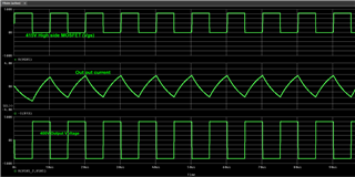

  • Hi Sean,
    It seems the FB circuit is worked in PSPICE for TI, uploaded herewith.
    I have a doubt with the gate-to-source voltage (Vgs) of my high-side MOSFET.
    • The Vgs of the low-side MOSFET is 15V, which makes sense.
    • However, for the high-side MOSFET, the gate voltage (VGHS) is 195V and the source voltage (VSHS) is 200V.
    I’m using a voltage-controlled voltage source for the high-side driver, and the MOSFET I’m working with has a gate voltage range specification of up to 20V. Is the high Vgs I'm seeing (415V) due to the floating voltage of the high-side MOSFET? How do I make sure the gate voltage is within the 20V range for safe operation? I am afraid this 415V destroy the MOSFET.

  • Hi Biruk,
    For the high side to turn on, it needs (Vgate - Vsource) =15. In the high-side, Vsource=400V when the switch is closed. You therefor need Vgate= 415V to keep the switch ON. Vgs is still 15V, so it will not destroy the Mosfet. Vgs is a floating voltage, since Vs is not 0V.
