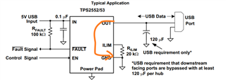

For TPS2553, when Vin=5V, EN is low, what's the leakage current or impedance from OUT to GND?

The device is powered from VIN, so the leakage path to ground is not specified and will be dominated by the ESD structure.
