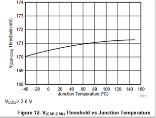

"Current sense amplifier gain"
This only lists the typ., but how much are the max and min?
Correct, the gain is a constant value as it is set by the internal resistance values to the IC. However, its accuracy can vary with temperature and at the min and max temperature operating conditions, its accuracy can vary up to approximately 10%-15%
