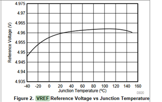

I have a question about the tps92692-Q1.
When setting the output current, the datasheet says to use
ILED = VIADJ / (14 *RCS).
And I understand that VIADJ can be calculated as
VIADJ = RADJ1 / (RADJ1 + RADJ2) * VREF
・ Can I consider ILED to be based only on the accuracy of the external components RADJ1, RADJ2, and RCS?
・ Can I consider VREF to be built in to 4%?
