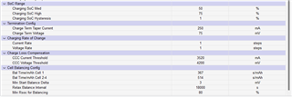

    I just realized that the green means 0 and therefore not enabled. As a follow up to my question below, which setting determines when the charging will be stopped once a certain voltage is reached in each of the cells? In other words, how can I determine whether the charging will be stopped at 12.6 V and not a lower value to make sure this is not the issue?
    Is this defined within the Advanced Charge Algorithm - Voltage Range table (please see below). The Charging Voltage High is currently set at 4000 mV. Does this mean the charging will be stopped once each cell reached 4000 mV?
    Thanks in advance for you help.
    Joe DeWitt

  • Hi Anthony,
    Thank you for the response. It is much appreciated. I will request the bqstudio log file of the charge cycle and the .gg file from the factory as they have been performing the charge cycles.
    In regards to the following calculation in the Valid Charge Termination Table you reference above, can you please confirm my understand of where these values are pulled from:
    Max cell voltage 1...4 + Charge Term Voltage >= Charging Voltage() / number of cells in series
    Max cell voltage: Real values read from Cell 1 Voltage, Cell 2 Voltage and Cell 3 Voltage in the Registers Table and will be the sum of the individual cell values for the calculation.
    Charge Term Voltage: User inputted value located in the Data Memory -> Advanced Charging Algorithm - >Termination Config table (see below which is 75 mV for my IC for each cell)
    Charging Voltage(): Charging Voltage High value which is user inputted from the Advanced Charge Algorithm -> Voltage Range Table -> Charging Voltage High (see below which is 4000 mV for my IC)
    Therefore, and assuming all the cells are at the same voltage, once the individual cell voltages are at 4000 mV - 75 mV = 3,925 mV and the other conditions specified in the Valid Charge Termination table are also met, the charging will stop.
    Is this understanding accurate?
    Thanks in advance for your support.
    Joe DeWitt

  • Hi Anthony,
    Can you confirm whether the statement below is also true in addition to the statements you confirmed above:
    If not, please advise regarding where the Charging Voltage() value is taken from.
    Joe DeWitt
  • Hi Joe,
    You are somewhat correct. The ChargingVoltage() is the parameter set in the Advanced Charge Algorithm section multiplied by the amount of cells in the stack:
    Anthony
