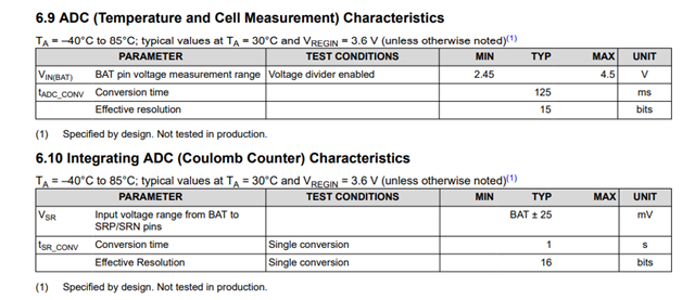

Hi Team,
Could you please tell me BQ27426 Internal ADC sampling frequency and sampling accuracy? Thanks
BRs,
Dillen Chen.

Hello Dillen,
For the sampling speed please refer to this E2E thread. For the Sampling accuracy please refer to the following image from the Datasheet.
Robert.
